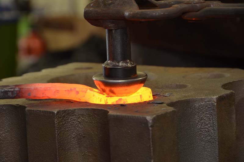

    I finally hit a little hot steel with the 3B I've been working on. I had problems with the drifts (die keys) coming loose, so I didn't get as much done as I had hoped. I did however, put together a little video that is now on YouTube. For any interested, you can find it at
    www.youtube.com/watch?v=h3gPMX2d_Gs&feature=channel
    I have worked on the drifts a bit and hope to be putting up more video later.
